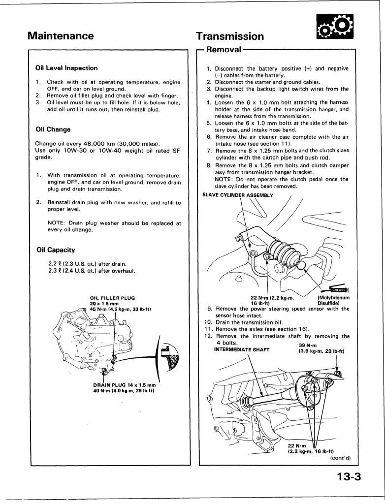

The starter motor is right under the intake tube that goes from the air filter housing to the throttle body, Might want to make sure you aren't low on MT fluid. Here's the info page:

Ok then it was the starter like it was trying to engage and disengage when the car was idling. The car was in neutral and I have no shifting problems. When you say check MT fluid that is just clutch fluid In the reservoir behind the brake reservoir??
90ls is offline   Reply With Quote
Old 04-14-2013, 08:25 PM   #9
Nope, MT fluid is in the transmission.
Old 04-14-2013, 08:48 PM   #10
90ls
Location: D.C
Posts: 223
90ls is on a distinguished road
How do I check it??
