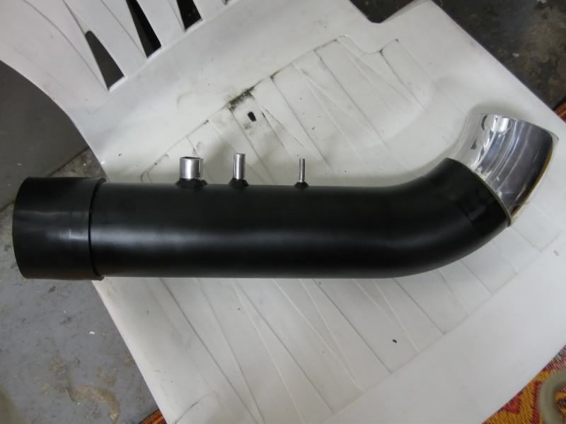

Depends on what you're getting/where you're getting it from. If you're buying a professionally made SRI from like Weapon R or one of the other big companies, they should have specifically made TCS SRIs in stock.
If you're looking for an eBay tube and buying a better filter, I never found anybody selling any cheap eBay TCS intake either. They were all non-TCS. You can contact the sellers and ask them if they have any TCS models in stock, because they used to just not advertise the TCS models in their ads unless you asked them for one. What I ended up doing was buying one of those non-TCS pipes and just cutting it to fit:
The bare aluminum section is what had to be cut off of the non-TCS pipe to make it fit on the TCS module. Everything fits fine on mine.
