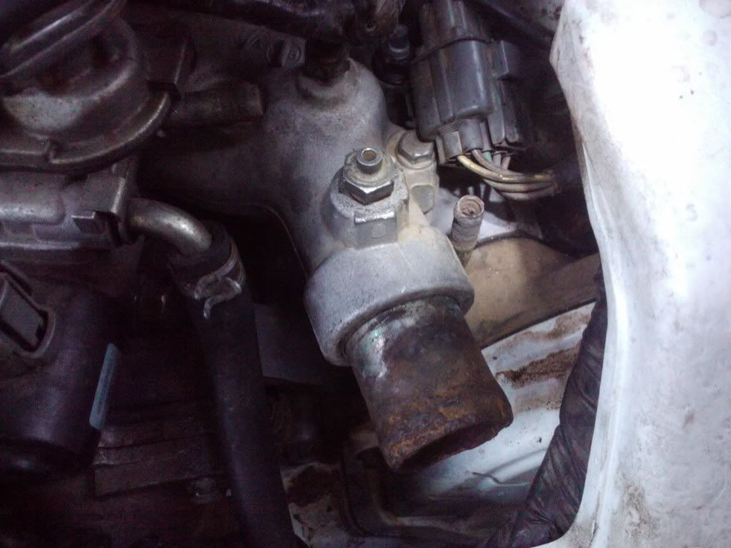

i found a clog in the system wich i think was the problem . i found a hose with a small hole .took that hose off and there was the clog ...its the lil pip on the right of the bleeder valve..i cant seem to unclog it . i tried clr,brake cleaner,and poking at it with no success . any tips? also what is that thing on the left of the bleeder valve that the hose with the hole i found do?.

the thing on the left is the IAC (idle air control) valve *I think*

isnt that one of the throttle body coolant hoses? I know its not involved in the bypass so im sure you need it. go ahead and un-clog that, and if thats clogged then im sure someone has put stop leak in your system. I suggest you give your system a good power flush lots of water, let everything clear out. then replace the thermostat with oem from acura.
also is your temperature gauge creeping up? any signs of the car overheating, are you losing coolant? having to refill.
any thing else weird happening to your car? out of the nore I'd be happy to help.

i bled it good ...no howling ,,,but the hose to that IAC valve had a hole in it , by the time i found that hole i ran out of light so im gonna buy the hose 2morrow ..so then the problem was that after i bled it and drove it ,air was getting in the system through that hole in the IAC hose right
