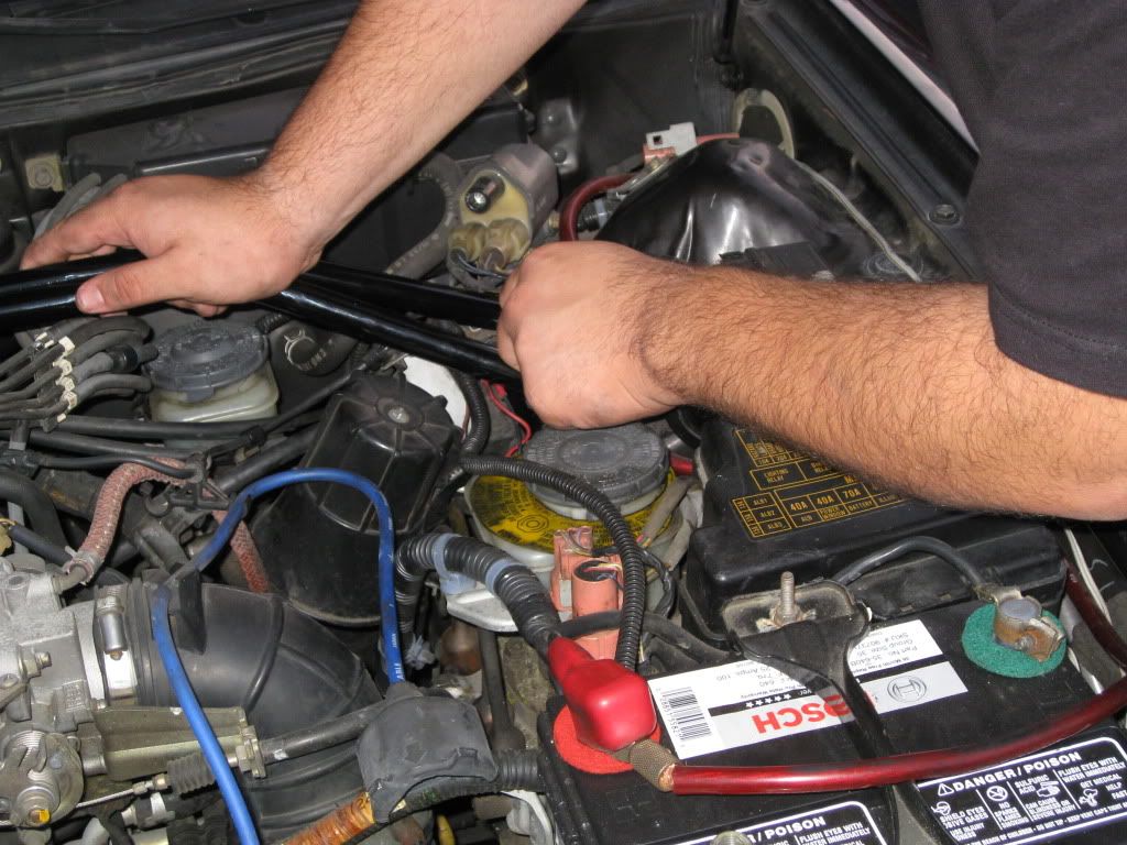

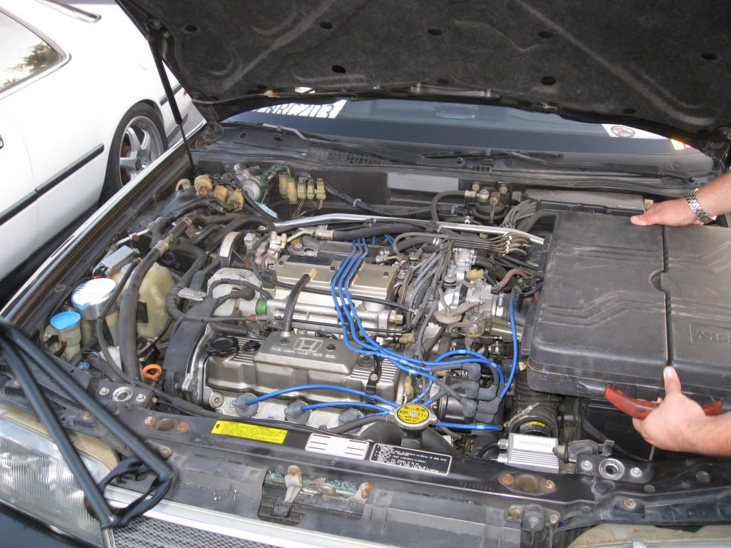

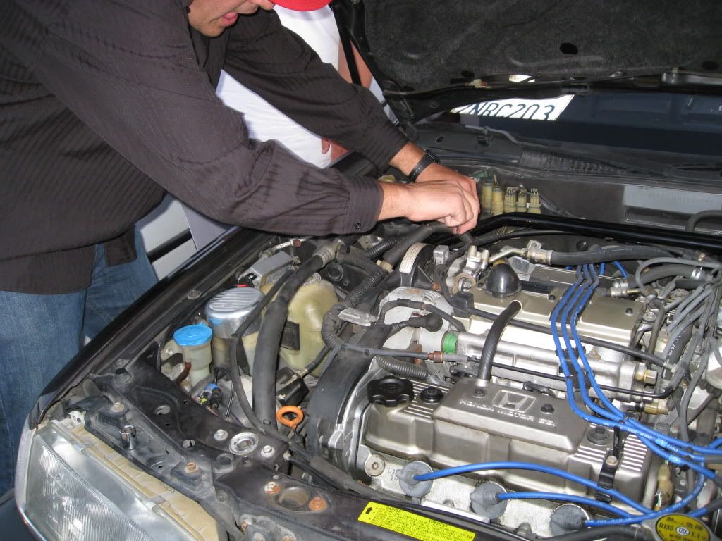

1. Remove the 3 14mm mounting nuts from each strut tower.
2. Size up and align the bolt holes on the bar.
3. If your chassis has flexed over time (most likely), aligning the holes may be somewhat difficult...jack up the front of the car from the tow hook as this may allow the body to flex back some and allow for easier installation.
4. Move any wires and vacuum lines out of the way to allow for installation of the bar.

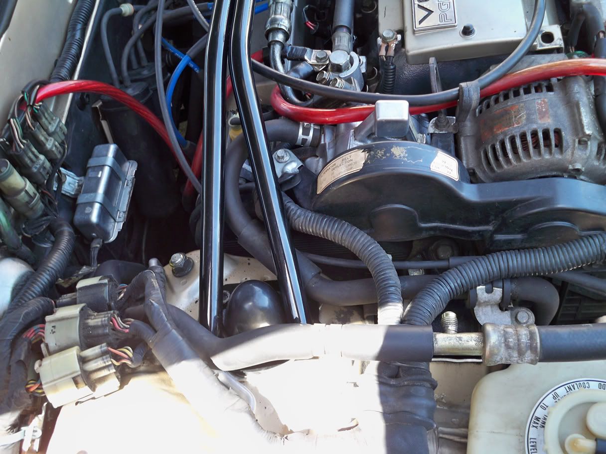

5. Replace and tighten up the 14mm nuts on both towers (a wrench will most definitely be needed for this step as a socket will not fit) and lower the car...
6. Route the power steering pump hose so that it is under the bar...you are ready to go!
