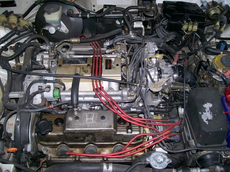

Feel free to use my JDM engine pics bro! You have full permission
Old 02-25-2011, 05:38 PM   #239
Or you can have either 89hondalegend, 3GCVC, or Travis to send you a better picture of their 2.7L JDM.
Old 02-25-2011, 07:01 PM   #240
89HondaLegend
Old School
Travis' isn't JDM.
However I can get you a pic of the JDM C27 in the Xi if you need.
Here's one of the Coupe...
Regards, Steve
Love to Love the Legend
