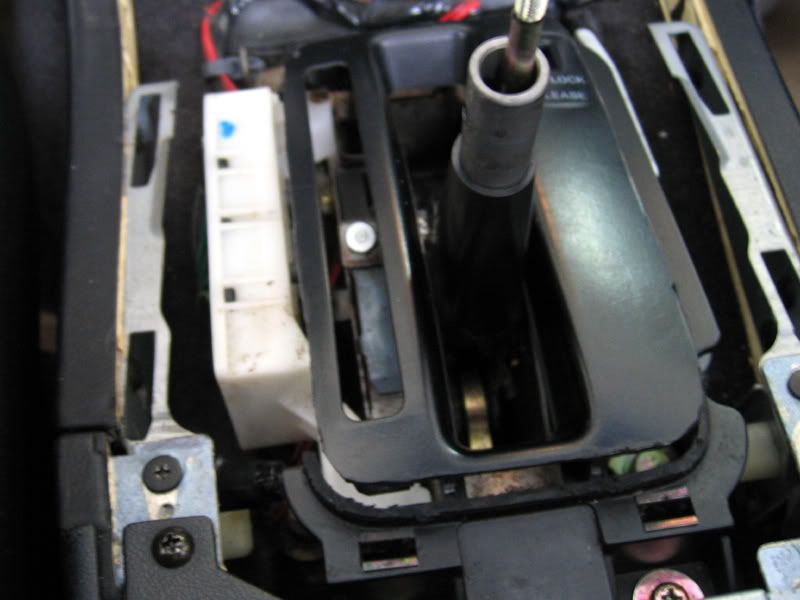

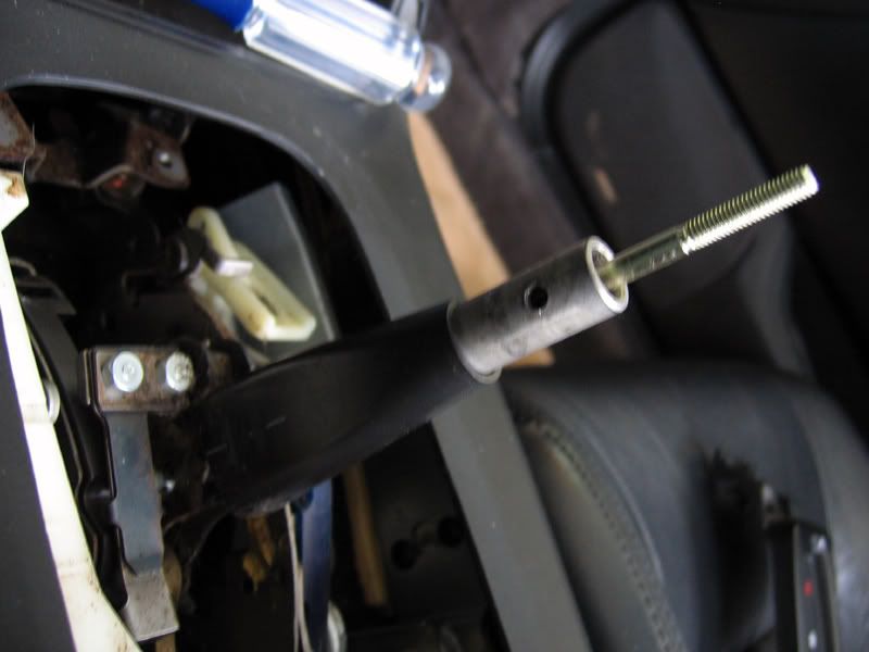

Step 1:
Remove your shifter and all of its components so the shifter shaft looks like this:

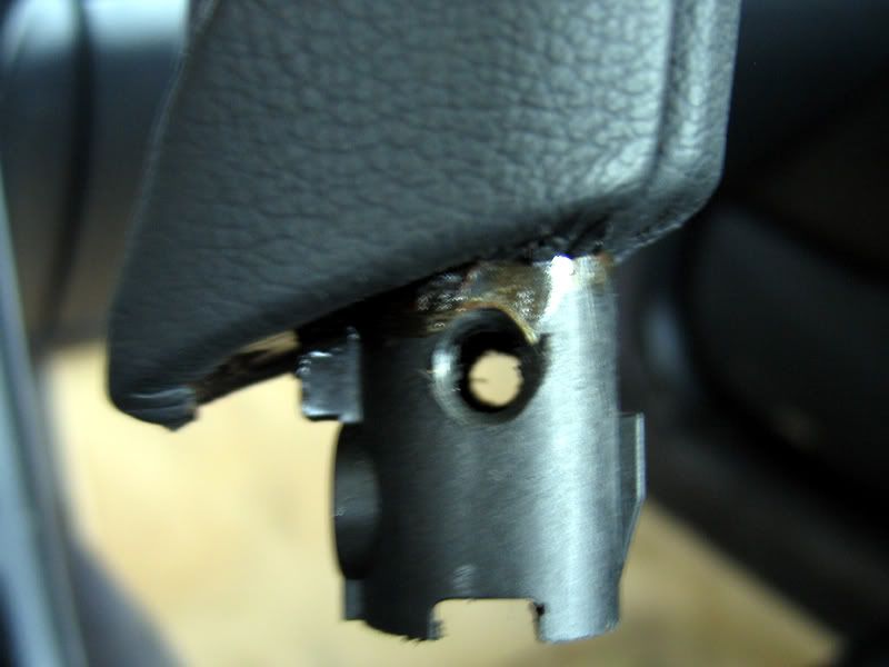

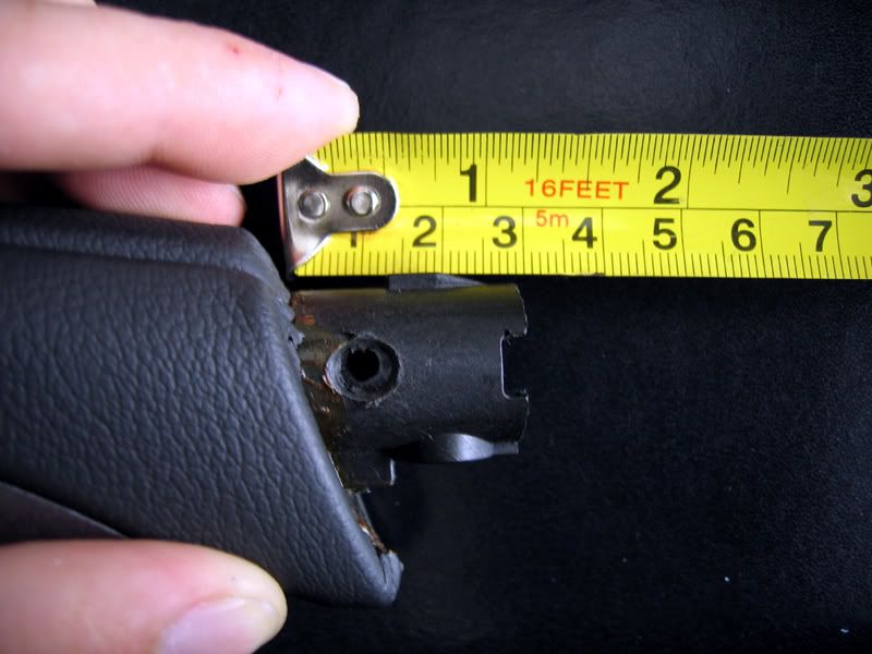

Step 2:
Leave about that much plastic on the MDX shifter; cut off the rest.
Step 3:
Drill a hole on both sides of the MDX shifter as pictured.

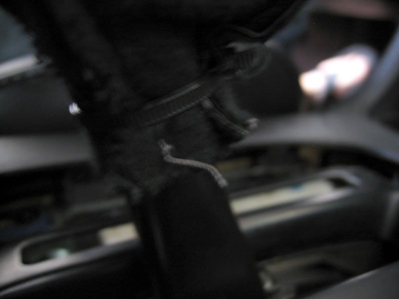

Step 6:
Pull the boot up and zip-tie the end around the shifter shaft, right below the knob.

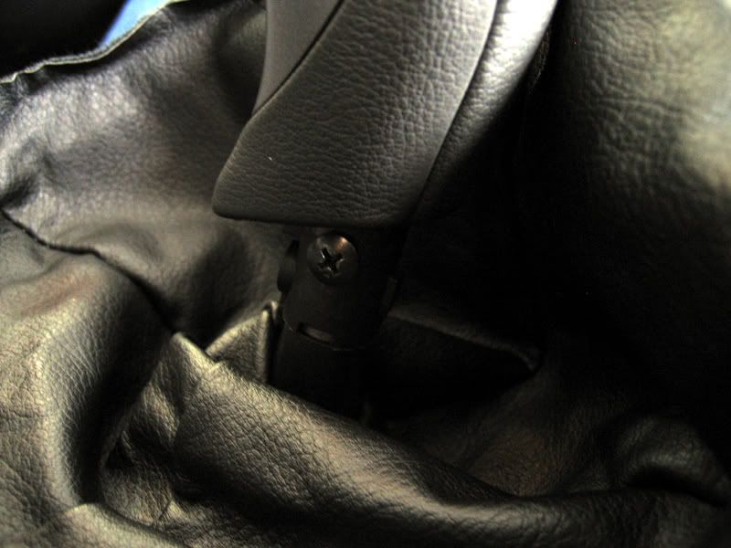

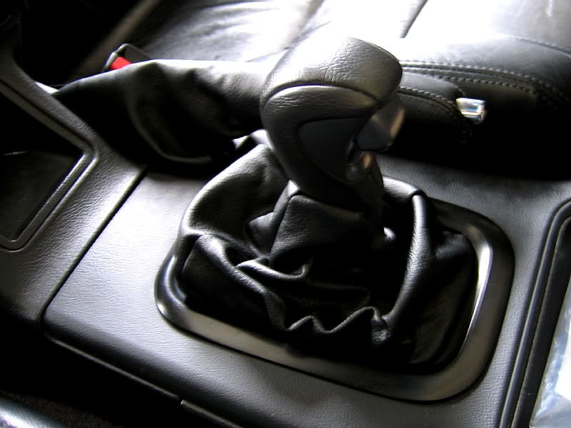

Step 7:
Pull the boot down, tuck it underneath the center console trim and place the black bezel/trim piece in place.
