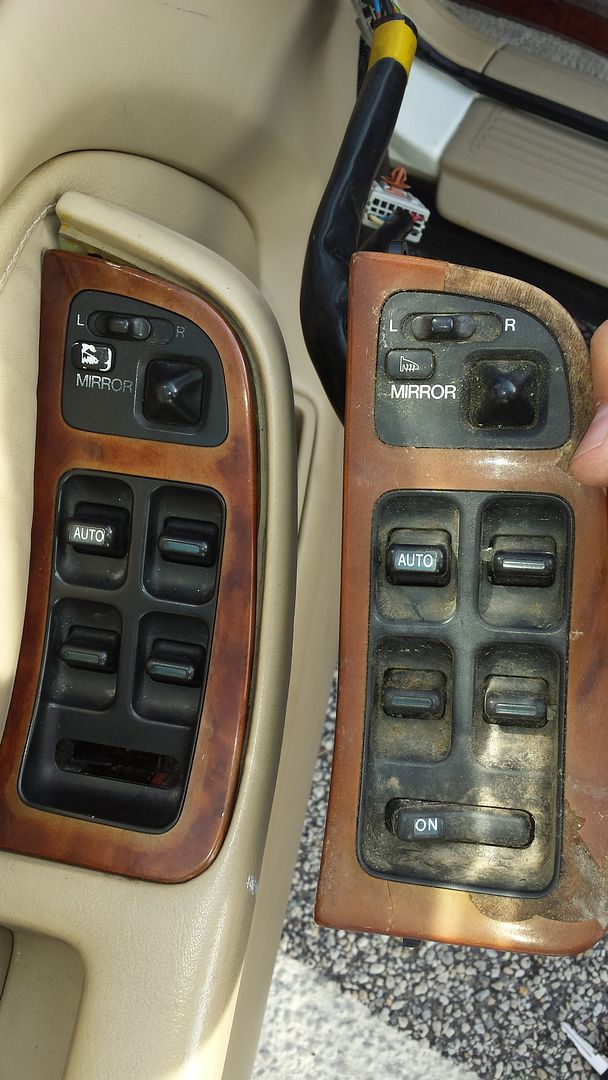

So I grabbed a master switch from a semi-local junkyard and switched it out. This one had a functioning safety lock, the one at the bottom. Here is a picture before I cleaned it up before I installed it.
Now three of my windows work. Drivers does not, I learned today the previous owner removed the window motor, and just stuck a block of wood to hold the window up.... lol
Power mirror only works up and down, not side to side. I do not think heat mirror works either.
However the memory seat switch I got seems to have a different connector than on mine... it was off a 93 or 92.

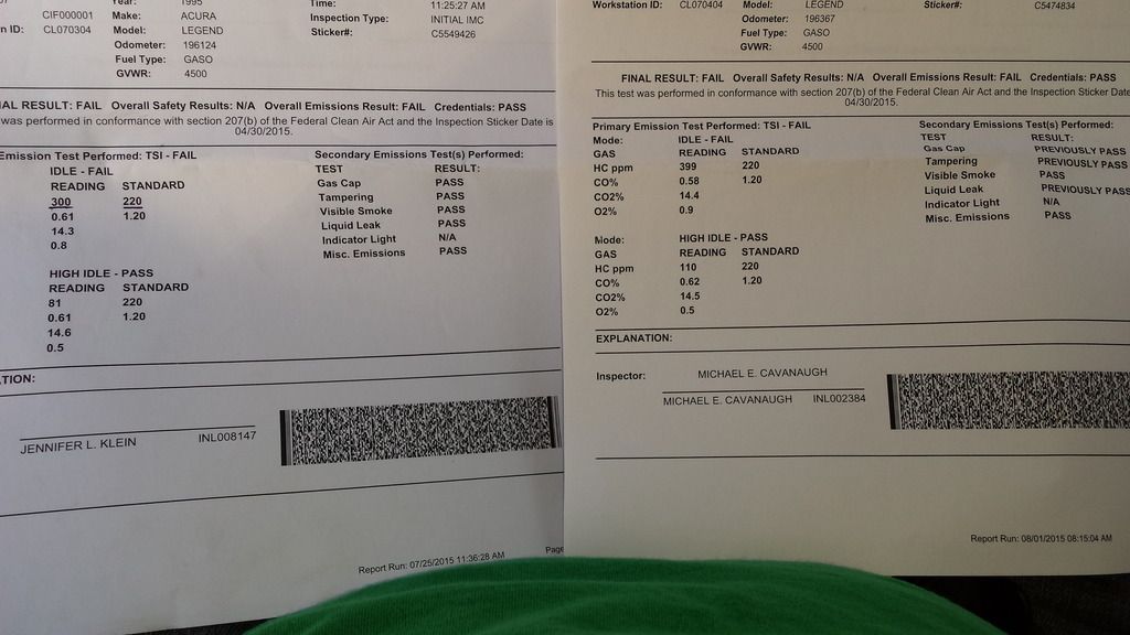

Pics of my emissions test.
On the left is first one, you can see better results. On the right is after a half tank of Techron added in, and a then a full tank of ultra Shell gas burned, followed by a bottle of Cata-Clean added in on a 1/4th tank, and then half filled with Sunnoco premium gas. It came out worse...

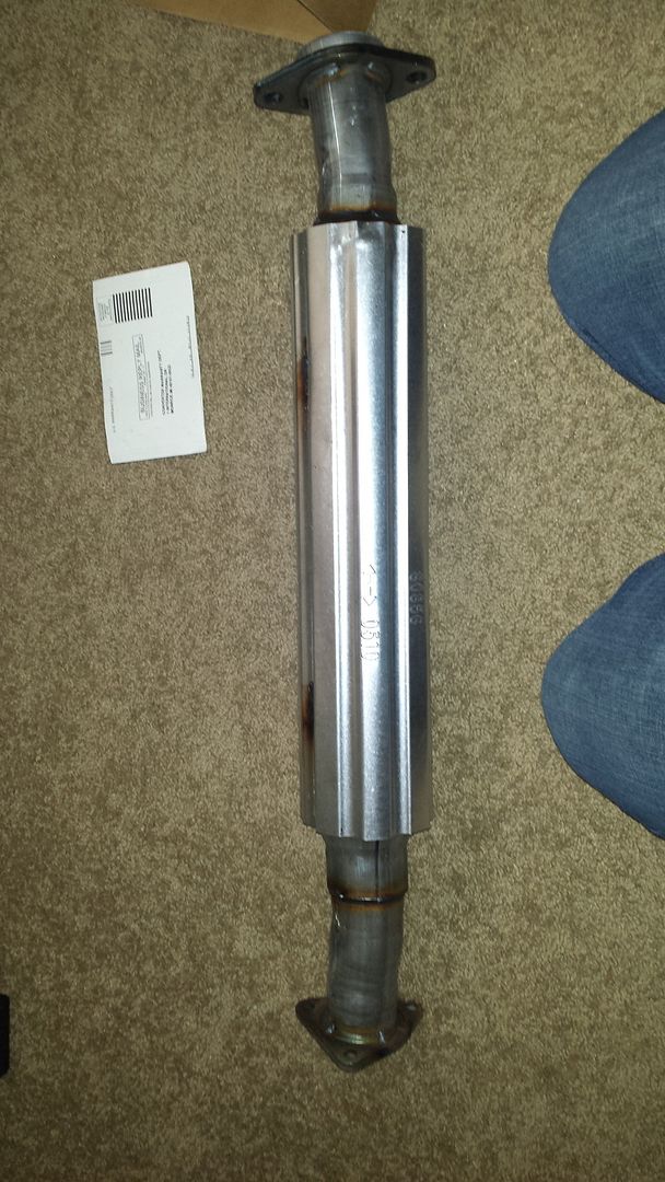

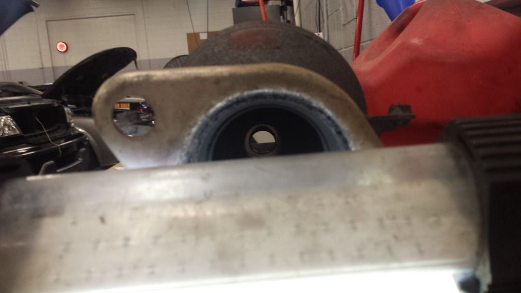

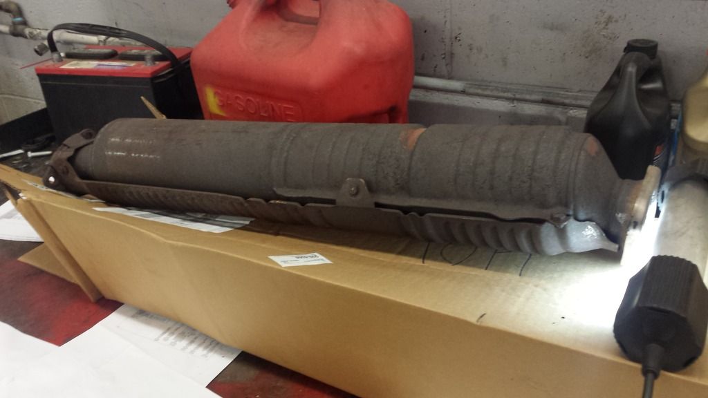

Had the Cat replaced at the school yesterday:

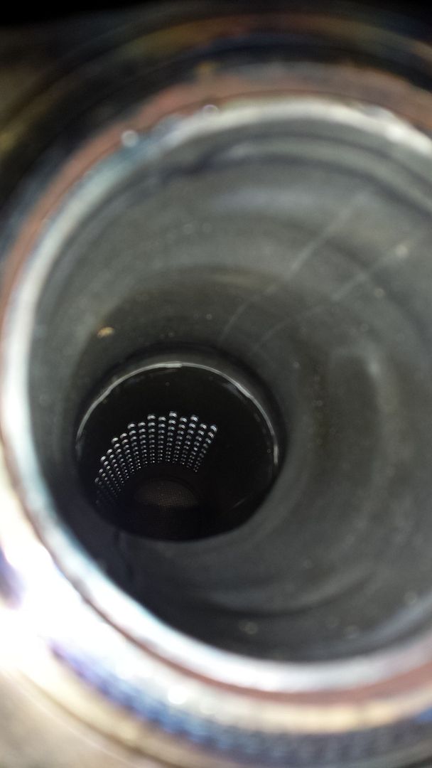

THERE'S your problem! The instructor said the old cat was a completely hallow shell. So for all intents and purposes, I was minus a Cat. Here is the new California compliant Walker Cat:
So drum roll please....
PASS!

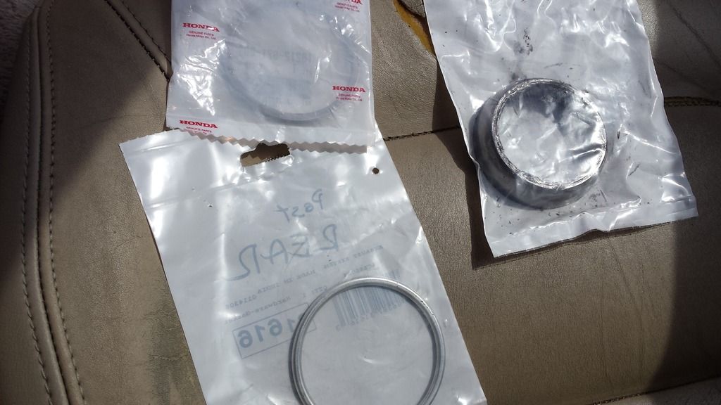

ANd I got the pre and post Cat gaskets, and the driver's side Exhuast-to-Manifold. Passed emissions without them, but still going to put them on today.
So why did I fail emissions? It couldn't be the Cat causing his HC readings.
Well rwheadon pointed to his signature... and it hit me.
I was seeing a puff of smoke when I first start the car in the morning. I am low on Oil. And high HC readings.
The valve stem seals were not changed when the Head Gasket job was done.... hgeez:
