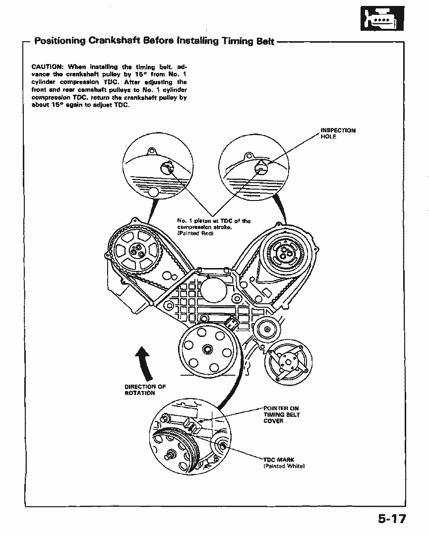

So is it like this when you had it on the TDC:

it looks like one of the marks are off on the crankshaft so i think i got to go through the hole process again.
^^^ it sure sounds like the culprit of your TDC fault... between db and l4zy, I'm sure you'll get this figured out in no time
yeah, that's sorta where i got messed up to. in the manual it tells you that there's 3 bunched up *those are the ignition timing marks* ...going with your eyes counterclockwise, the next line is the white one *the TDC mark in the above FSM page* and the next one after that is a blue line that is for double checking the tensioners operation and readjusting it.
tell you the truth, i ended up accidentally setting my T-Belt to the ignition timing marks and i ended up liking the end effect.. gave it some more umph, at least i'm pretty sure that's what happened. but for now i'd stick with gettin it lined up with the TDC mark and messing with the timing with a timing light afterwards. if the marks aren't lined up like in that diagram, it's off. *the two cam marks showing from the rubber holes, and the crank mark lined up with the front cover's needle* if only two are lined up, then it's off.
you could try turning the dizzy cap too to see if it's the distributor by itself.. when you put it back in, if it was off by a tooth, the spark contacts won't be in the correct position for ignition timing. great thing about dizzy's tho is that you can spin the cap some and see if it's just off a tooth. it'll still give a spark at the plug if it's off, it just won't be doing it at the right time. did you make marks on the dizzy when you replaced it?
