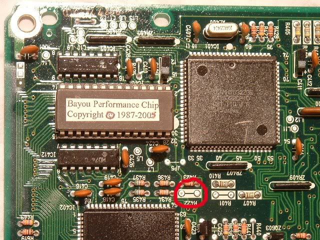

any auto ecu can be converted for MT by cutting a resistor.
Yes, but no lockout. Whole point of t2 mt ecu is the lockout IMO.

Wrong. The automatic and 6spd boards are completely identical. Cut the resistor and the trans daughter board out of any automatic 93-95 ECU (even type I's) and it will control the reverse lockout.

confirmed. cutting this resistor will make the lock out work:
-Matt
Always wondered if that was possible. So to clarify, the auto daughterboard can run the reverse lockout for 6mt's. Does this ECU need to be chipped? The lockout is already there? Almost got this figured out. Thanks
